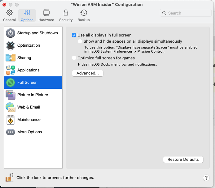

        I’m not familiar with VMWare, but in Parallels there are a couple of places in the VM configuration settings that refer to full screen. One is in the startup settings, and one under “Full Screen. I run all my VMs full screen. It may also have to do with the aspect ratio of the display of the host vs the guest.
        See screenshots – maybe you have similar settings.
