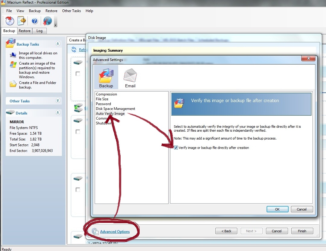

      Specifically, I use Macrium Reflect Free to make backup images. I can’t find any way to verify the image before committing to a Restore operation. (You can only verify as part of the Restore operation.) Do any of the other free backup utilities (such as Acronis) offer verification after creation of an image? I would like to verify it immediately, so that if it were found to be defective, I could immediately re-do the image.
      Macrium Reflect is fully capable of verifying an image upon creation:
      32067-3
      But this by no means negates the need to test by restoring the image just made.
