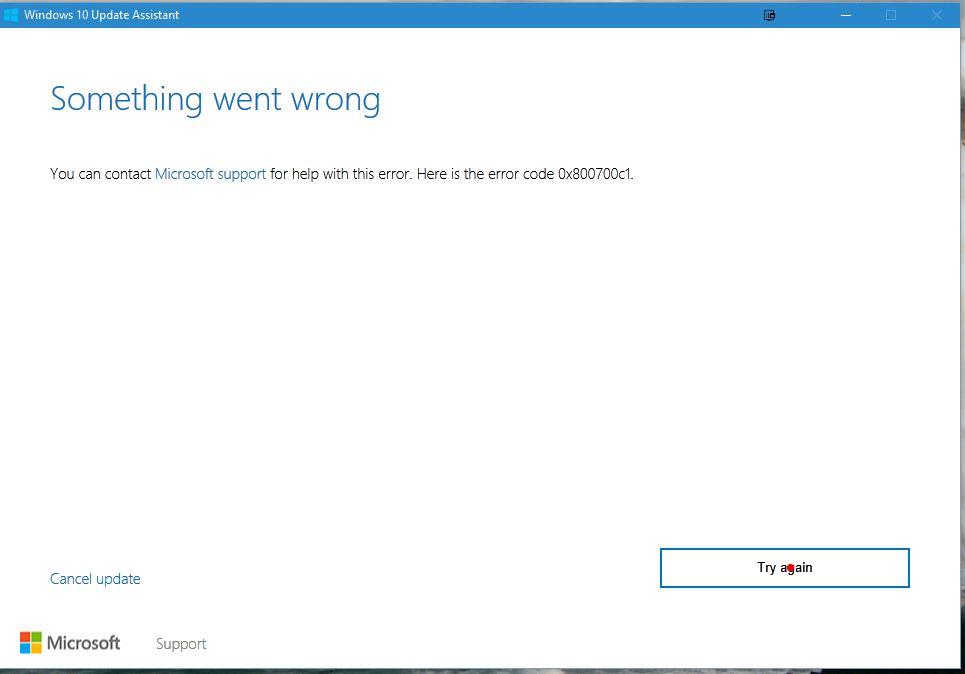

    I’m running Windows 10 Pro Version 10.0.10586 Build 10586, 64 bit on a Lenovo Thinkpad W541. My Thinkpad has a SSD (drive C:) with Windows and programs on it, but all users files located at drive D:Users[username]….
    I made 5 attempts to update my system with the “Windows 10 Update Assistance” which reports the following:
    45553-20160914-Windows-10-Update-Assistant-00
    After grinding through the whole download/ installing updates process the following dialogue appears:
    45554-22019014-Windows-10-Update-Assistant-Something-Wrong
    Same result at every attempt.
    This is an exceedingly unhelpful error code.
    Extensive searches with Google has failed to find an explanation and/or fix for this error, and I’ve trieds a few that have been suggested. I thought of shifting Users back to C:Users and trying again, but 600GB of user data will not fit on the 256GB SSD with the system and program files:(
    Any brilliant ides to resolve this issue.

        Thanks for your suggestion but all attempts to upgrade where made using an Administrator account.
        Also tried:
          [*]Clean boot
          [*]Stopping all programs that load at startup
          [*]Stopping all non-Microsoft Services
          [*]Disconnecting all external devices except ethernet, ie no USB sticks, USB HDD, USB Speaker
        Still no joy.
        BygAuldByrd

      Have you tried using the Media Creation Tool?
      • #1577774
        Thanks for the thought.
        I hadn’t, so I did the “Update” process using the Media Creation Tool from [HTML]https://www.microsoft.com/en-au/software-download/windows10[/HTML] with the following “highly illuminating” result:
        And that was it – no indication whatever as to the nature of the cause of the failure:(
        Still looking for a solution that doesn’t involve a clean instal.
        Cheers
        BygAuldByrd

        I’ve just completed another attempt at Windows 10 Pro Anniversay Update, this time by:
          [*]Downloading the Windows 10 Pro 64 bit ISO file from https://www.microsoft.com/en-au/software-download/windows10
          [*]Creating a DVD Windows 10 Pro (64 bit) installation disk
          [*]Running “Setup.exe” from the DVD
        and after about 2 hours came up with the following “amazing” result:
        I’ve attached copies of:
          [*]The Event Viewer > Winodws Logs > System for the duration of the attempted Update.
          [*]The WindowsUpdate.log (The relevant period for the Update attempt is 17 Sep 2016 from 10:50 to 13:00).
        I can’t see anything in those Logs that point me to the cause of the Update failures.
        Are there other more relevant Logs? If so, where do I find them?
        Any further suggestions appreciated.
        Cheers
        BygAuldByrd

      • #1579535
        Hi All,
        I’ve just had another go at upgrading Windows 10 Pro v1511 to the Anniversay Update. Success at last:)
        Here’s the latest synopsis:
          [*]I have my Windows system on Drive C: (a 220GB SSD with 93GB used) and the user profiles at D:Users[Username] (a 931GB HDD with 604GB used).
          [*]Created Windows 10 Pro Anniversary Update using the Media Creation Tool.
          [*]Created a System Image and Recovery Disk of drive C:. My drive D: data is already double backed-up.
          [*]Following various advice, I attempted to move D:Users[Username], (except “Documents”, “Music” and “Videos” – they’re too big) back to the C: drive using the instructions to “Move Users (and possible ProgramData) back to C: drive” from [HTML]http://www.tenforums.com/tutorials/1964-users-folder-move-location-windows-10-a.html[/HTML], but that failed at my first attempt with an inability to run the “Sysprep” process.
          [*]Later in the referenced instructions is comment to the effect that “Sysprep” will not run on an upgraded system, so I followed the instructions to modify the Registry Entry at HKEY_LOCAL_MACHINESYSTEMSetup to delete the KEY “Upgrade” and DWORD “Upgrade” and at HKEY_LOCAL_MACHINESYSTEMSetupStatusSysprepStatus and ensure that the DWORDs “CleanupState” and “GeneralizationState” both had a value of 7.
          [*]I disconnected my Internet connection, disabled the WiFi and Ethernet adapters.
          [*]I did a bit of housekeeping on drive C: by deleting the renaming the following folders (which I after everything else was tried and tested, I deleted them):
          [INDENT]$GetCurrent
          $SysReset
          $WINDOWS.~BT
          $Windows.~WS
          Windows10Upgrade[/INDENT]
          [*]Before trying again, I killed “Windows Defender” and “Malwarebytes Anti-Malware” and all other running applications.
          [*]Attempted yet again to move D:Users[Username] back to the C: drive and this time it worked, but as part of the process I had to create a New User and needed to enter my Windows 10 Pro Product Key. This time it worked without any issues.
          [*]While still logged in as my “new user”, I then attempted the Windows 10 Pro Anniversay Update yet again :crossfingers:
          [*]After a number of reboots I was able to logon with my usual Username and Password.
          [*]So I typed “Winver” into the “Run” dialogue and found that I now had Windows 10 Pro version 1607 installed.
        Wonders will never cease — it worked:fanfare: Hooray:clapping:
        Oops:confused: What’s this, some of my setup has been changed and now I have to try and find my way around the changes that have been made in Windows 10 Pro Anniversary Update and set things up again the way I like them:(:
        Cheers
        BygAuldByrd:cheers:
