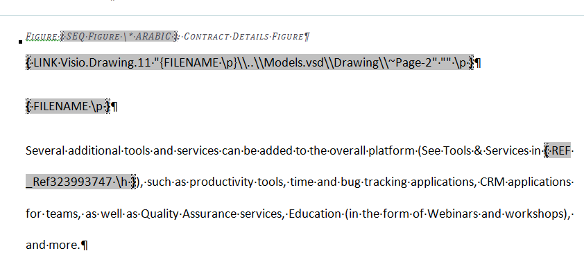

      Hello. I’m trying to use your relative paths method for using LINK in Word 2003 SP3 to connect to a PowerPoint slide. I’ve tried your macro as you set out in your post and, while it runs, it seems to replace the brace field delimiter characters with some other unrecognisable character, rendering the field useless. I end up with the following:
      { LINK PowerPoint.Slide.8 ” FILENAME p ..AAT Course Notes Jan 09.ppt” “448” d }
      You can see the delimiters have been removed from around the FILENAME p term and replaced with something else (it just shows up as a rectangle in the Word document).
      Perhaps it’s some kind of character set issue?
      Any thoughts would be much appreciated.
      • #1145663
        Hi gecko,
        Welcome to the Lounge.
        Judging by the field code included in your post, it seems you’re trying to combine the use of the FILENAME field and the macro to manage a LINK field. The FILENAME field can’t be used in a LINK field – you can only use the macro.
        Cheers,
        Paul Edstein
        [Fmr MS MVP - Word]
        • #1145697
          Many thanks, Paul. Silly me – I was thinking the macro was in addition to your FILENAME procedure, not as a replacement for it. Does this mean that if I’ve got my PPT file in the same folder as the Word doc, that I should remove the pathname entirely from the link – as per the following?:
          { LINK PowerPoint.Slide.8 “AAT Course Notes Jan 09.ppt” “448” d }
          The original slide link after I pasted it into Word, was as follows:
          { LINK PowerPoint.Slide.8 “C:DataAATAAT Course Notes Jan 09.ppt” “448” d }
          In both cases, however, I get the same result with the macro – the moment I change the underlying slide, it disappears from the Word document and is replaced by the following message:
          Error! Not a valid link.
          I made sure to attach your macro file to the Word document and saved it, even before pasting any slide links into it. Also, just to point out I only need the PPT and DOC files to be in the same folder, but this folder is likely to be shunted around drives with different drive-letters.

      First, my original links look like this:
      { LINK Excel.Sheet.8 “\\Stlfile\finance\John Doe\Notes\Company One.xls” “Balance Sheet!BalanceSheet” a p * MERGEFORMAT }
      This link is showing the path on the network, the file name, the tab name of Balance Sheet and the range name of Balance Sheet. I do need to maintain the formatting.
      After applying your method, should it look like this:
      { LINK Excel.Sheet.8 “{ FILENAME p}/../Company One.xls” “Balance Sheet!BalanceSheet” a p * MERGEFORMAT }
      Or like this:
      { LINK Excel.Sheet.8 “{ FILENAME p}\..\Company One.xls” “Balance Sheet!BalanceSheet” a p * MERGEFORMAT }
      I’m not sure what the difference is between /../ and \..\ for this type of situation. Can you explain for me?

    • #1191257
      As a follow-up to my post above, whenever I change the links as described above, they work even after I save the file. I have the option turned off to update the links upon closing the file. When I subsequently open the file, I get the message that the file has links to data in other files and do I want to update the data. If I choose NO, the file opens and the links are as they were when I saved them. However, if I choose YES, the links are converted back to their original absoute file paths. The same thing happens if I chhose NO but then later update the links manually. I am using Word 2007 and Excel 2007 but both files are saved as 2003 file extensions if this makes a difference.

      Hi Ervin,
      As mentioned in my original post, the fieldcode modifications do not work with LINK fields. That’s because LINK fields have the nasty habit of converting any embedded fields to their plain text equivalents immediately the fields are updated. Accordingly, you need to employ the macro-based solution.
      The a and p are switches – the a tells the field to automatically update to reflect changes in the data source. The p tells Word to represent the link as an image. As an aside, you can delete the ‘* MERGEFORMAT’ – it does nothing useful in this context.
      Cheers,

      Before
      { LINK Excel.Sheet.8 “\\Stlfile\Finance\Ervin\Notes to the Financial Statements\Company Inc.xls” “Balance Sheet!BalanceSheet” a p * MERGEFORMAT }
      After
      { LINK “\\Stlfile\Finance\Ervin O’Neal\Notes to the Financial Statements\Company Inc.xls” “Balance Sheet!BalanceSheet” a p * MERGEFORMAT }
      Also, if I close the Word file and reopen it, the Link formulas keep building upon themselves as seen below
      { LINK Excel.Sheet.8 “\\Stlfile\Finance\Ervin O’Neal\Notes to the Financial Statements\Company Inc.xls” Income!Income FinanceErvin O’NealNotes to the Financial StatementsCompany Inc.xls “\\Stlfile\Finance\Ervin O’Neal\Notes to the Financial Statements\Company Inc.xls!Income!Income” “” a p * MERGEFORMAT }
      Thanks,

      Hi Ervin,
      Running the macro as posted, I am unable to replicate the behaviour you’re reporting using either Word 2000 or Word 2007.
      In my testing, ‘LINK Excel.Sheet.8’ remains unchanged, as does the filename and the field switches – all that changes is the filepath (as intended) and I get no duplication of the filepath on subsequent re-openings of the document.
      Cheers,

      I’m trying to get the file name removed from the FILENAME field by using macropod’s suggestion in Office 2010:
      {INCLUDEPICTURE “{FILENAME p}\..\Image.png”}
      How this works: The FILENAME p field extracts the current file’s name and path. The following ‘\..\’ or ‘/../’ tells Word to ignore the filename and get just the path. Then all you need to do is to add the source file’s name & extension.
      The same approach can be extended to implement a form of relative addressing. For example:
      {INCLUDEPICTURE “{FILENAME p}\..\My PicturesImage.png”}
      looks in the child folder named ‘My Pictures’ and:
      {INCLUDEPICTURE “{FILENAME p}\..\..\Image.png”}
      looks in the parent folder, while:
      {INCLUDEPICTURE “{FILENAME p}\..\..\My Pictures\Image.png”}
      looks in the parent folder, then its child folder named ‘My Pictures’ (a sibling folder, so to speak).
      But I can’t get Word to go to the parent folder. See 1.PNG and 2.PNG. I’ve tried //..//, \..\, .., /../, /, \, //, , and everything in between. I’m also interested in some other way of achieving this. Maybe through string manipulation using the = (Formula) field?
      31769-231770-1
    • #1345791
      Hi aJacom,
      You can’t remove the Filename from a FILENAME field. I’m not aware of anything in the post you refer to that suggests otherwise.
      I see that you’re also trying to use this technique with a LINK field. As clearly stated in the post you’ve quoted from, you cannot use this technique with a LINK field – you need the macro-based solution for LINK fields. The macro-based solution also works with the INCLUDETEXT, INCLUDEPICTURE, etc. fields.
      Formula fields are incapable of performing the required string manipulations.
      Cheers,
      Paul Edstein
      [Fmr MS MVP - Word]
