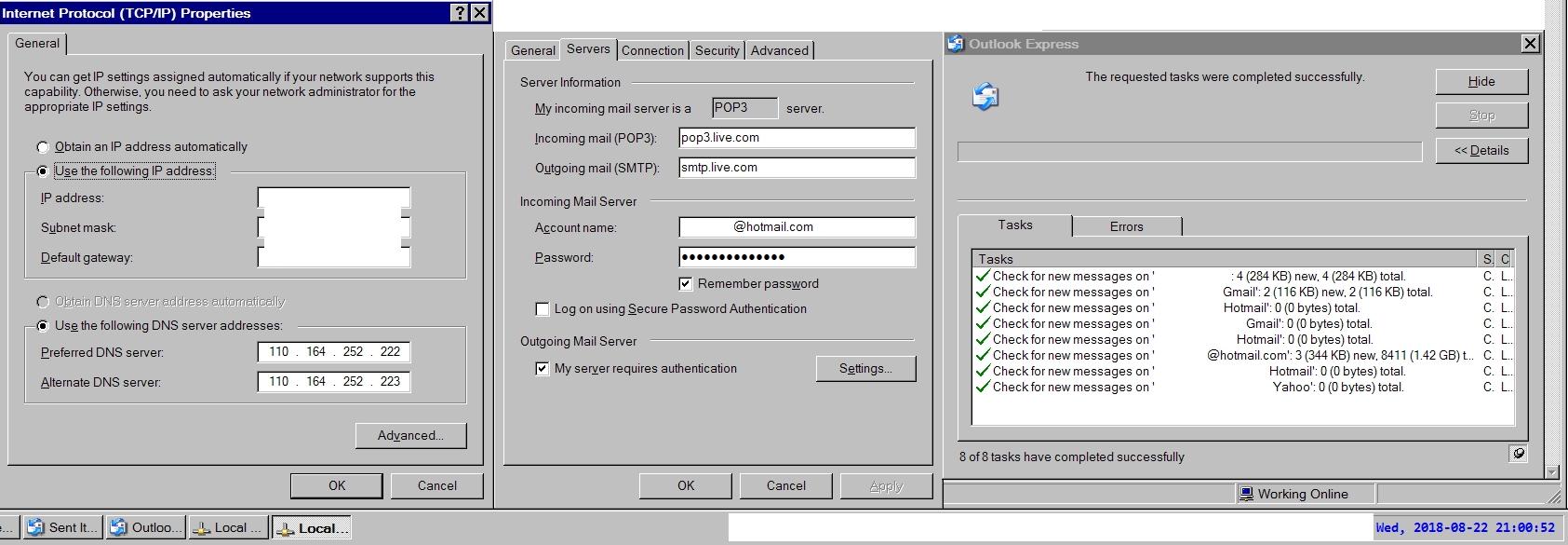

That’s a good idea! Yes, “Paul T” suggested my ISP could be having problems. I didn’t think of it being a DNS problem though.
The DNS that I am using is Google’s – 8.8.8.8 – with the alternate being 8.8.4.4.
I will try my ISP’s DNS service as I’m sure I have read that there are many people who say there is little advantage in using 8.8.8.8 other than it is easy to remember!
If the problem continues, then at least it is a variable that we can ignore.
Today, though, all is well – the .live.com servers are accessible without problems. Touch wood.
Stay tuned – I’ll let you know what happens.

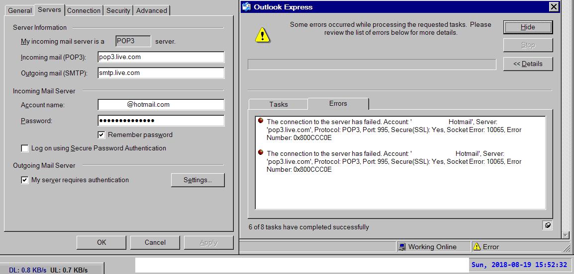

AskWoody LoungerAfter a week of pop3.live.com and smtp.live.com working flawlessly, a new situation has arisen. Starting about 3pm on 19th August, access by Outlook Express to the first two Hotmail accounts fails, and then a minute later they work.
On 19th August at 13:12, all were working:
Then, at 15:52, access to the first two accounts failed:
But another “Send / Receive All Mail” just a minute later worked perfectly:
– and they continued to work the rest of the day.
The same happened yesterday and today. It feels like I have to wake up the servers by trying to access two accounts, and then after they’ve woken up they stay awake.
I could post screen shots from yesterday and today, but they are the same as the ones above – the first two Hotmails fail, the second two work, and then a minute later they all work and stay working.

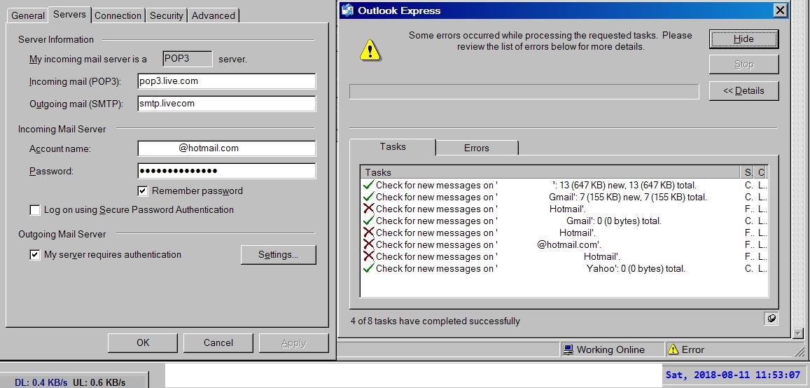

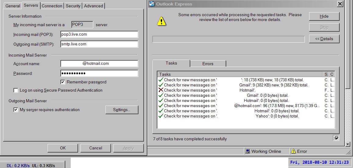

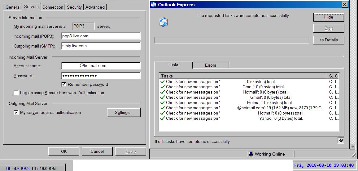

August 10th 01:00 – both live.com and outlook.com not workingUpdate:
August 10th 12:30 outlook.com working ~ 90 old emails from 5th August received again.
The one failure in the image above is for an account that I deliberately left using “live.com”. After changing it to use “outlook.com” it was OK.Brain storming: Is there a chance that this could be my ISP having “problems”? (3BB – Thailand)

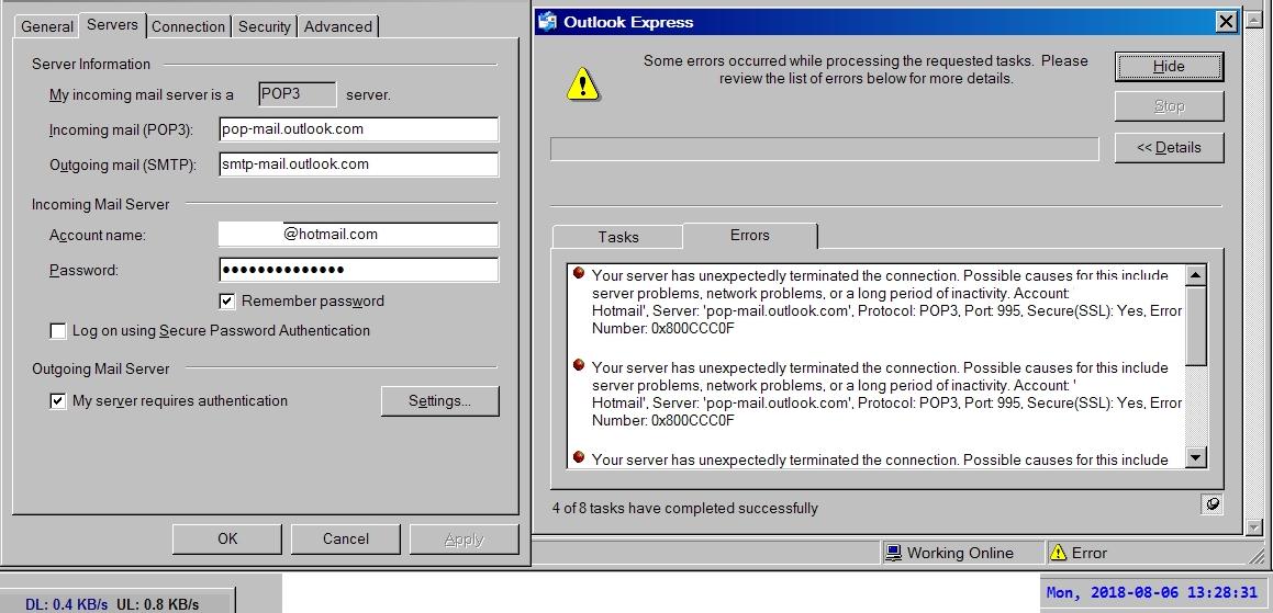

AskWoody LoungerIf it’s Monday, it must be “Back to pop3.live.com”-day:
All mail.outlook.com servers failed:
Same error message:
Switched back to the old pop3.live.com servers:
– and got 33 messages, all bar 6 were old and dated back to August 2nd, when the last switch occurred.
