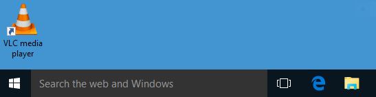

    • #1524344
      CLiNT,
      Or just switch to a Local Account. This method let’s you keep the search box.
      41815-LocalAcctSearchBox
      Sample:
      41816-LocalAcctSearchBox1
      Personally, I’m not real keen on this whole MS Account thing (Snowdenphobia) 😆
