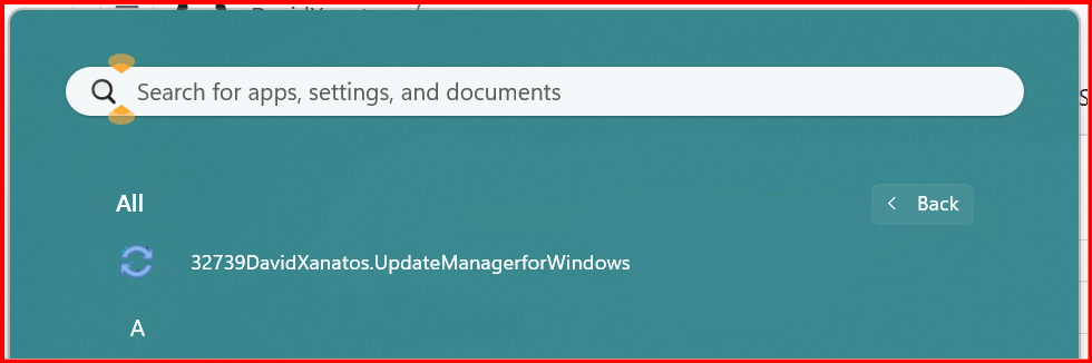

      • #2757224
        7. You can’t install it.
        It gets installed if downloaded from Microsoft Store (but works same).
        WuMgr-installed
