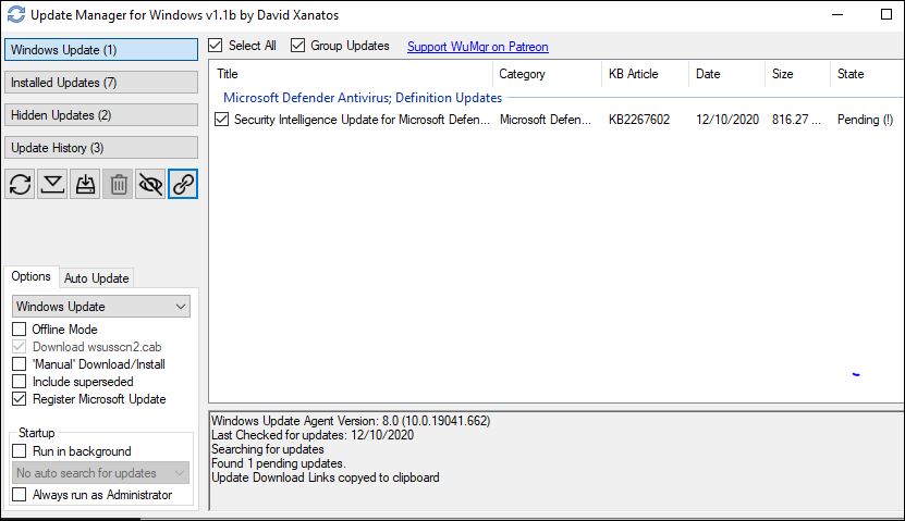

      Link command:
      Select the circle on the far left.
      wum14
      Check the update where you wish to see the link.
      Select the box with the chain.
      This notice will appear at the bottom of WuMgr.
      Update Download Links copyed to clipboard
      Open Notepad and do a paste:
      wum15

            OK – I “think” it downloaded, but I can’t be sure.
            WuMgr now shows this:
            WuMgr-1
            How do I access that file and install it?
            Thanks!

              Thanks so much! I did finally figure it out and that I also needed to click on the Install button!
              So – will this update only show in the WuMgr list – not on the WU list itself?
              Seemed pretty fast and easy. Now I’m going to try to do the 21H1 update that I had put off a while ago due to connection issues. If I reset Group Policy to allow that version, where will I see it – in WuMgr or WU, or both?
              Thanks again for the help!
